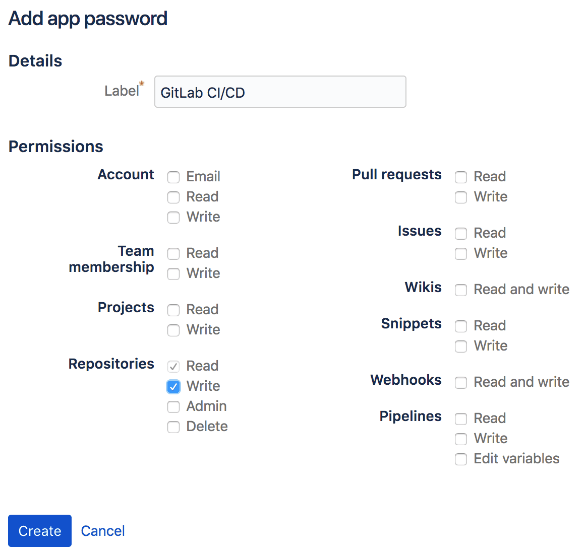

  4. In Bitbucket, create an App Password from Bitbucket Settings > App Passwords to authenticate the build status script setting commit build statuses in Bitbucket. Repository write permissions are required.
    Bitbucket Cloud webhook
