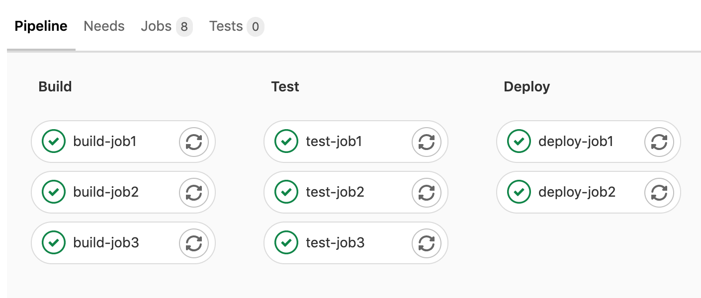

Visualize pipelines
Pipelines can be complex structures with many sequential and parallel jobs.
To make it easier to understand the flow of a pipeline, GitLab has pipeline graphs for viewing pipelines and their statuses.
Pipeline graphs can be displayed as a large graph or a miniature representation, depending on the page you access the graph from.
GitLab capitalizes the stages’ names in the pipeline graphs.
View full pipeline graph
- Visualization improvements introduced in GitLab 13.11.
The pipeline details page displays the full pipeline graph of all the jobs in the pipeline.
You can group the jobs by:
Stage, which arranges jobs in the same stage together in the same column.
Job dependencies, which arranges jobs based on their
needs
dependencies.

Pipeline mini graphs
Pipeline mini graphs take less space and can tell you at a quick glance if all jobs passed or something failed. The pipeline mini graph can be found when you navigate to:
- The pipelines index page.
- A single commit page.
- A merge request page.
Pipeline mini graphs allow you to see all related jobs for a single commit and the net result of each stage of your pipeline. This allows you to quickly see what failed and fix it.
Pipeline mini graphs only display jobs by stage.
Stages in pipeline mini graphs are collapsible. Hover your mouse over them and click to expand their jobs.
Mini graph | Mini graph expanded |
