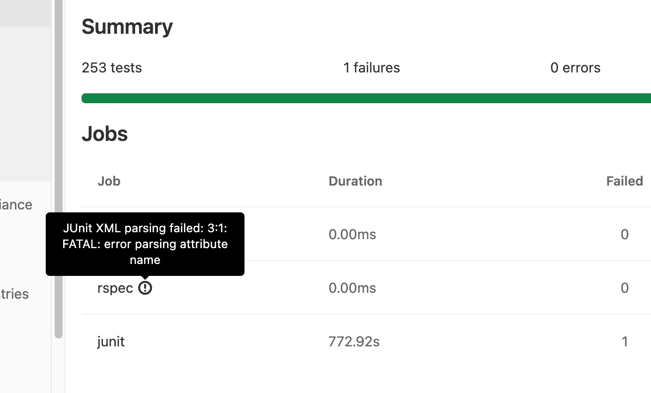

Unit test reports parsing errors
Introduced in GitLab 13.10.
If parsing JUnit report XML results in an error, an indicator is shown next to the job name. Hovering over the icon shows the parser error in a tooltip. If multiple parsing errors come from grouped jobs, GitLab shows only the first error from the group.
