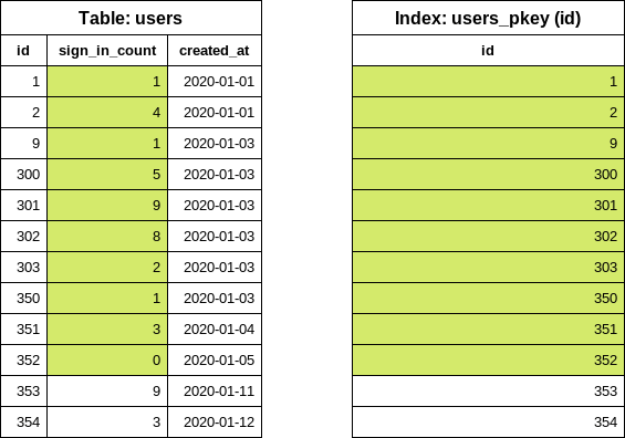

each_batch will produce the following SQL query for the start id value:
SELECT "users"."id" FROM "users" WHERE "users"."sign_in_count" = 0 ORDER BY "users"."id" ASC LIMIT 1
Selecting only the id column and ordering by id is going to “force” the database to use the index on the id (primary key index) column, however we also have an extra condition on the sign_in_count column. The column is not part of the index, so the database needs to look into the actual table to find the first matching row.
Reading the index with extra filter
noteThe number of scanned rows depends on the data distribution in the table.
  • Best case scenario: the first user was never logged in. The database reads only one row.
  • Worst case scenario: all users were logged in at least once. The database reads all rows.
In this particular example the database had to read 10 rows (regardless of our batch size setting) to determine the first id value. In a “real-world” application it’s hard to predict whether the filtering is going to cause problems or not. In case of GitLab, verifying the data on a production replica is a good start, but keep in mind that data distribution on GitLab.com can be different from self-managed instances.

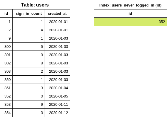

Improve filtering with each_batch
Specialized conditional index
CREATE INDEX index_on_users_never_logged_in ON users (id) WHERE sign_in_count = 0
This is how our table and the newly created index looks like:
Reading the specialized index
This index definition covers the conditions on the id and sign_in_count columns thus makes the each_batch queries very effective (similar to the simple iteration example).
It’s rare when a user was never signed in so we anticipate small index size. Including only the id in the index definition also helps keeping the index size small.
