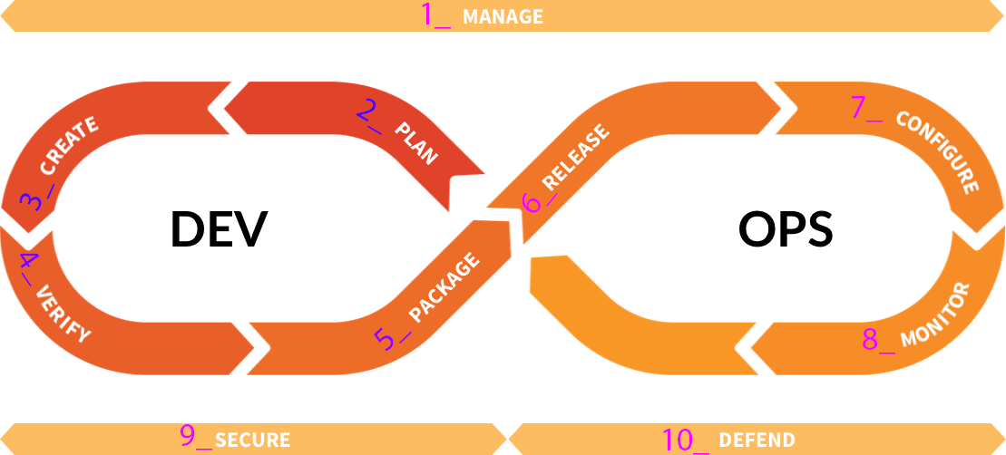

Identify the DevOps stage
The GitLab QA end-to-end tests are organized by the different stages in the DevOps lifecycle. Determine where the test should be placed by stage, determine which feature the test belongs to, and then place it in a subdirectory under the stage.
DevOps lifecycle by stages
If the test is Enterprise Edition only, the test is created in the features/ee directory, but follow the same DevOps lifecycle format.
