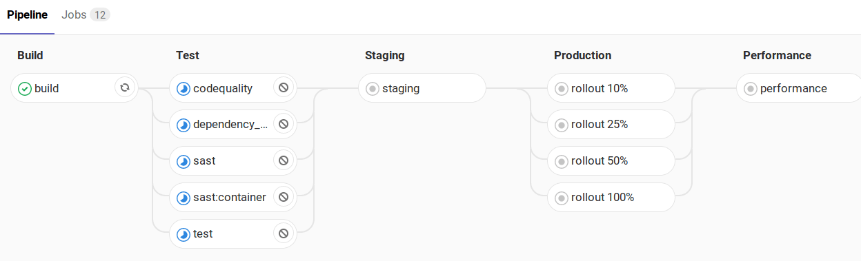

If INCREMENTAL_ROLLOUT_MODE is set to manual in your project, then instead of the standard production job, 4 different manual jobs are created:
  1. rollout 10%
  2. rollout 25%
  3. rollout 50%
  4. rollout 100%
The percentage is based on the REPLICAS CI/CD variable, and defines the number of pods you want to have for your deployment. If the value is 10, and you run the 10% rollout job, there is 1 new pod and 9 old ones.
To start a job, click the play icon () next to the job’s name. You’re not required to go from 10% to 100%, you can jump to whatever job you want. You can also scale down by running a lower percentage job, just before hitting 100%. Once you get to 100%, you can’t scale down, and you’d have to roll back by redeploying the old version using the rollback button in the environment page.
Below, you can see how the pipeline appears if the rollout or staging variables are defined.

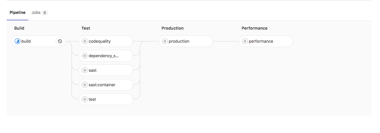

Without INCREMENTAL_ROLLOUT_MODE and without STAGING_ENABLED:
Staging and rollout disabled
Without INCREMENTAL_ROLLOUT_MODE and with STAGING_ENABLED:
Staging enabled
With INCREMENTAL_ROLLOUT_MODE set to manual and without STAGING_ENABLED:
Rollout enabled
With INCREMENTAL_ROLLOUT_MODE set to manual and with STAGING_ENABLED
Rollout and staging enabled
