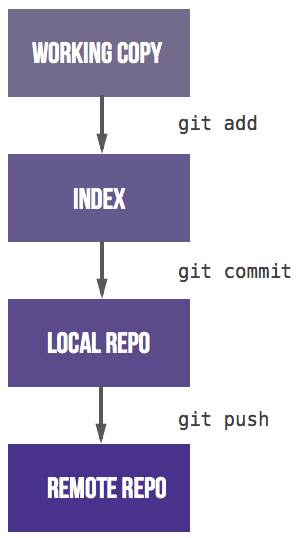

Four stages (working copy, index, local repository, remote repository) and three steps between them
When converting to Git, you have to get used to the fact that it takes three steps to share a commit with colleagues. Most version control systems have only one step: committing from the working copy to a shared server. In Git, you add files from the working copy to the staging area. After that, you commit them to your local repository. The third step is pushing to a shared remote repository. After getting used to these three steps, the next challenge is the branching model.
