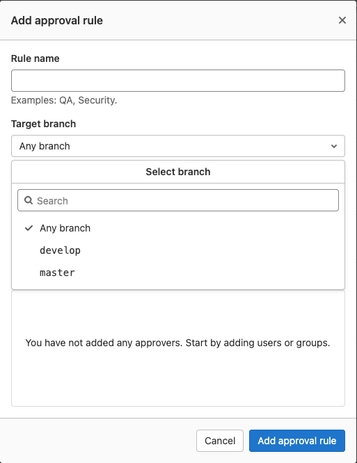

To add a merge request approval rule:
- Go to your project and select Settings > General.
- Expand Merge request (MR) approvals, and then select Add approval rule.
- Add a human-readable Rule name.
- Set the number of required approvals in Approvals required. A value of
0
makes the rule optional, and any number greater than0
creates a required rule. -
To add users or groups as approvers, search for users or groups that are eligible to approve, and select Add. GitLab suggests approvers based on previous authors of the files changed by the merge request.
On GitLab.com, you can add a group as an approver if you’re a member of that group or the group is public. - Select Add approval rule.

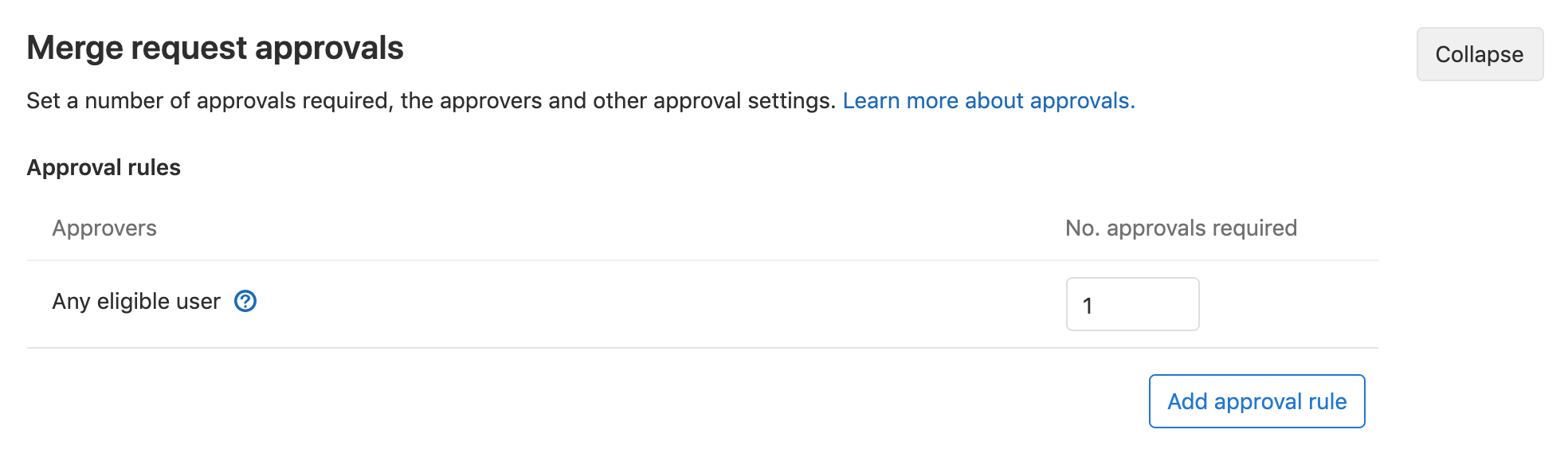

To edit a merge request approval rule:
- Expand Merge request (MR) approvals, and then select Edit.
- (Optional) Change the Rule name.
- Set the number of required approvals in Approvals required. The minimum value is
0
. - Add or remove eligible approvers, as needed:
To remove users or groups, identify the group or user to remove, and select Remove.
- Select Update approval rule.

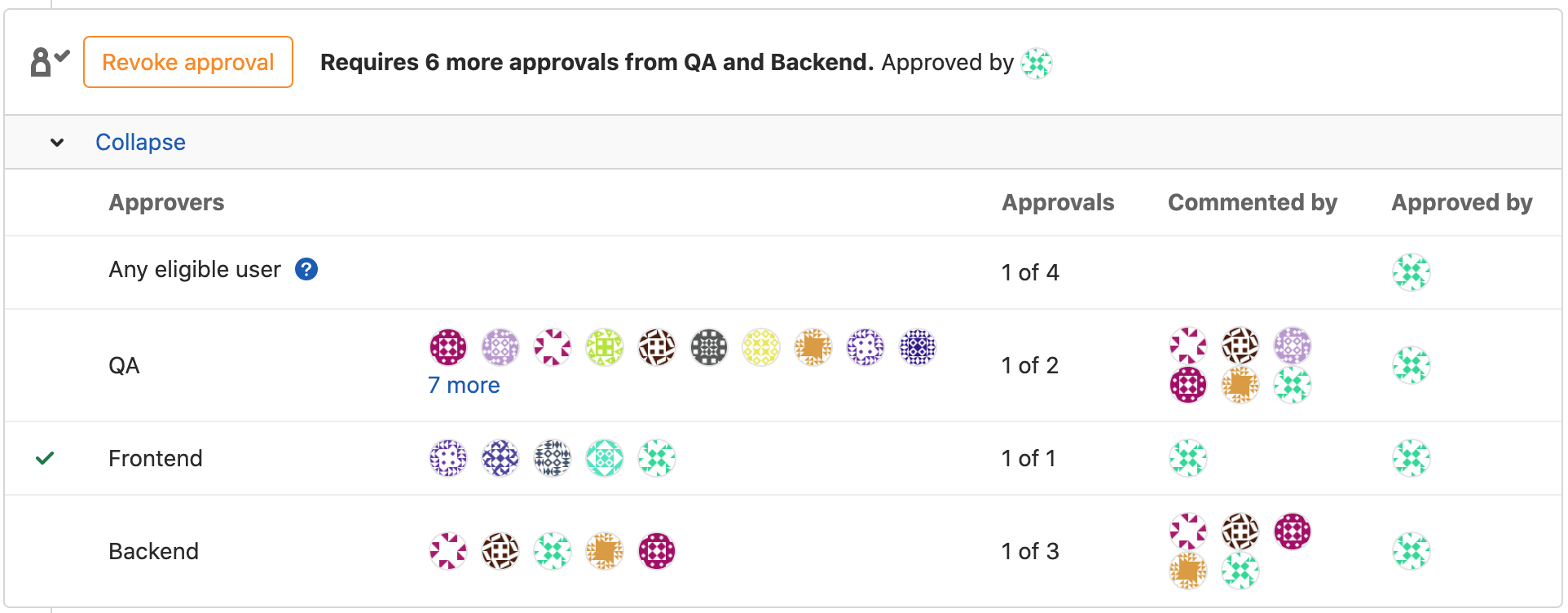

In GitLab Premium and higher tiers, you can enforce multiple approval rules on a merge request, and multiple default approval rules for a project. If your tier supports multiple default rules:
- When adding or editing an approval rule for a project, GitLab displays the Add approval rule button even after a rule is defined.
- When editing or overriding multiple approval rules on a merge request, GitLab displays the Add approval rule button even after a rule is defined.
When an eligible approver approves a merge request, it reduces the number of approvals left (the Approvals column) for all rules that the approver belongs to:

To show who has participated in the merge request review, the Approvals widget in a merge request displays a Commented by column. This column lists eligible approvers who commented on the merge request. It helps authors and reviewers identify who to contact with questions about the merge request’s content.
- Expand Merge request (MR) approvals.
Locate Any eligible user and select the number of approvals required:

Approval rules are often relevant only to specific branches, like your default branch. To configure an approval rule for certain branches:
- Create an approval rule.
- Go to your project and select Settings.
- Select a Target branch:
