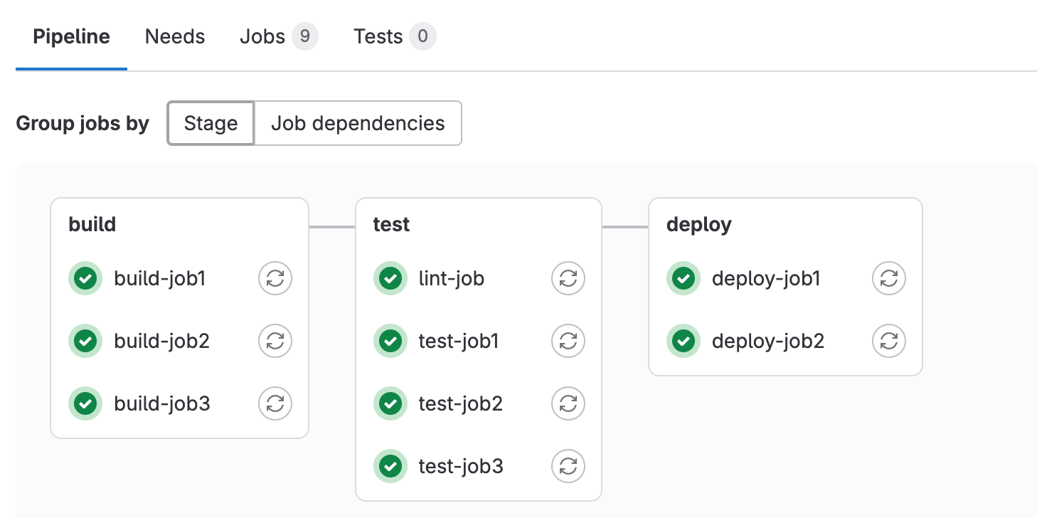

Select a pipeline to open the pipeline details page which shows every job in the pipeline. From this page you can cancel a running pipeline, retry failed jobs, or delete a pipeline.
The pipeline details page displays a graph of all the jobs in the pipeline:

Group jobs by stage or needs
configuration
When you configure jobs with the needs
keyword, you have
two options for how to group the jobs in the pipeline details page. To group the jobs
by stage configuration, select stage in the Group jobs by section:
To group the jobs by needs
configuration, select Job dependencies.
You can optionally select Show dependencies to render lines between dependent jobs.
Jobs in the leftmost column run first, and jobs that depend on them are grouped in the next columns. In this example:
lint-job
is configured withneeds: []
and depends on no jobs, so it displays in the first column, despite being in thetest
stage. -
test-job1
depends onbuild-job1
, andtest-job2
depends on bothbuild-job1
andbuild-job2
, so both test jobs display in the second column. - Both
deploy
jobs depend on jobs in second column (which themselves depend on other earlier jobs), so the deploy jobs display in the third column.
When you hover over a job in the Job dependencies view, every job that must run before the selected job is highlighted:
