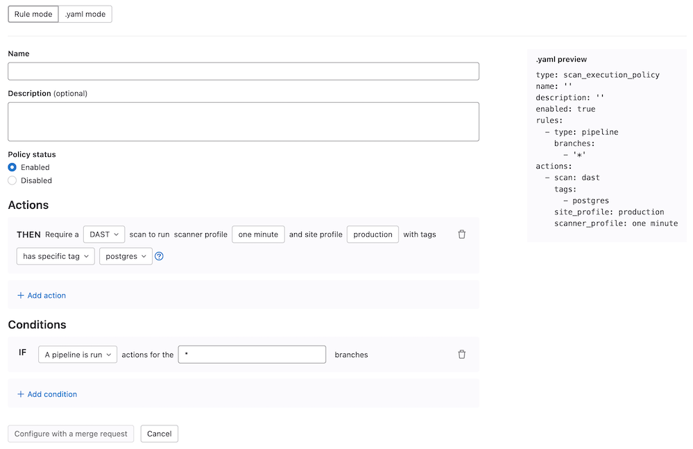

Scan execution policy editor
Use the scan execution policy editor to create or edit a scan execution policy.
Prerequisites:
- Only group, subgroup, or project Owners have the permissions to select Security Policy Project.
Once your policy is complete, save it by selecting Configure with a merge request at the bottom of the editor. You are redirected to the merge request on the project’s configured security policy project. If one does not link to your project, a security policy project is automatically created. Existing policies can also be removed from the editor interface by selecting Delete policy at the bottom of the editor.
Most policy changes take effect as soon as the merge request is merged. Any changes that do not go through a merge request and are committed directly to the default branch may require up to 10 minutes before the policy changes take effect.
