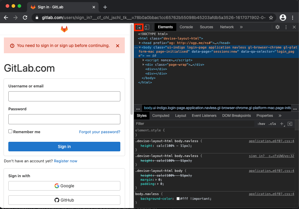

Find selectors with Google Chrome
Chrome DevTools element selector tool is an effective way to find a selector.
- Open Chrome and go to the page where you would like to find a selector, for example, the login page for your site.
- Open the
Elements
tab in Chrome DevTools with the keyboard shortcutCommand + Shift + c
in macOS orCtrl + Shift + c
in Windows or Linux. - Select the
Select an element in the page to select it
tool. - Select the field on your page that you would like to know the selector for.
- After the tool is active, highlight a field you wish to view the details of.
- Once highlighted, you can see the element’s details, including attributes that would make a good candidate for a selector.
In this example, the id="user_login"
appears to be a good candidate. You can use this as a selector as the DAST username field by setting
DAST_AUTH_USERNAME_FIELD: "id:user_login"
