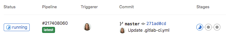

View the status of your pipeline and jobs
Now take a look at your pipeline and the jobs within.
Go to Build > Pipelines. A pipeline with three stages should be displayed:
View a visual representation of your pipeline by selecting the pipeline ID:
View details of a job by selecting the job name. For example,
deploy-prod
You have successfully created your first CI/CD pipeline in GitLab. Congratulations!
