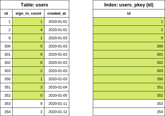

SELECT "users"."id" FROM "users" WHERE "users"."sign_in_count" = 0 ORDER BY "users"."id" ASC LIMIT 1
Selecting only the id
column and ordering by id
forces the database to use the
index on the id
(primary key index) column however, we also have an extra condition on the
sign_in_count
column. The column is not part of the index, so the database needs to look into
the actual table to find the first matching row.
- Best case scenario: the first user was never logged in. The database reads only one row.
- Worst case scenario: all users were logged in at least once. The database reads all rows.
In this particular example, the database had to read 10 rows (regardless of our batch size setting)
to determine the first id

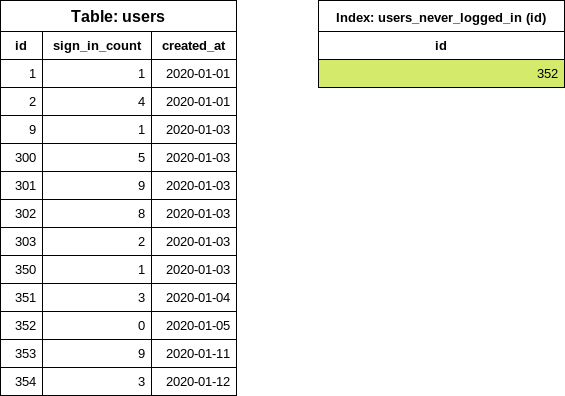

Specialized conditional index
CREATE INDEX index_on_users_never_logged_in ON users (id) WHERE sign_in_count = 0
This is how our table and the newly created index looks like:
This index definition covers the conditions on the id
and sign_in_count
columns thus makes the
each_batch
queries very effective (similar to the simple iteration example).
It’s rare when a user was never signed in so we a anticipate small index size. Including only the

iterate over an unknown number of entries in the index, and then find the first item where the
sign_in_count
is 0
We can improve the query significantly by swapping the columns in the index definition (prefer).
CREATE INDEX index_on_users_never_logged_in ON users (sign_in_count, id)
The following index definition does not work well with each_batch
(avoid).
CREATE INDEX index_on_users_never_logged_in ON users (sign_in_count)
Since each_batch
builds range queries based on the id
column, this index cannot be used
efficiently. The DB reads the rows from the table or uses a bitmap search where the primary
key index is also read.
