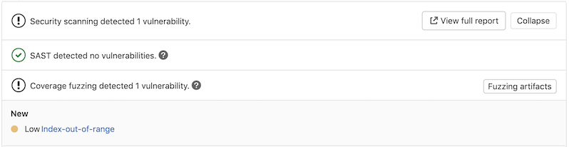

Interacting with the vulnerabilities
After a vulnerability is found, you can address it. The merge request widget lists the vulnerability and contains a button for downloading the fuzzing artifacts. By selecting one of the detected vulnerabilities, you can see its details.
You can also view the vulnerability from the Security Dashboard, which shows an overview of all the security vulnerabilities in your groups, projects, and pipelines.
Selecting the vulnerability opens a modal that provides additional information about the vulnerability:
- Status: The vulnerability’s status. As with any type of vulnerability, a coverage fuzzing vulnerability can be Detected, Confirmed, Dismissed, or Resolved.
- Project: The project in which the vulnerability exists.
- Crash type: The type of crash or weakness in the code. This typically maps to a CWE.
- Crash state: A normalized version of the stack trace, containing the last three functions of the crash (without random addresses).
- Stack trace snippet: The last few lines of the stack trace, which shows details about the crash.
- Identifier: The vulnerability’s identifier. This maps to either a CVE or CWE.
- Severity: The vulnerability’s severity. This can be Critical, High, Medium, Low, Info, or Unknown.
- Scanner: The scanner that detected the vulnerability (for example, Coverage Fuzzing).
- Scanner Provider: The engine that did the scan. For Coverage Fuzzing, this can be any of the engines listed in Supported fuzzing engines and languages.
