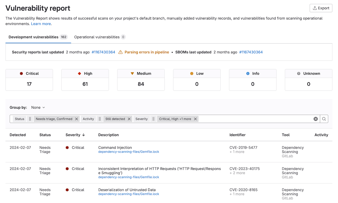

The Vulnerability Report provides information about vulnerabilities from scans of the default branch. It contains cumulative results of all successful jobs, regardless of whether the pipeline was successful. The scan results from a pipeline are ingested either after the job in the pipeline is complete or when the pipeline is blocked by manual jobs. The report is updated by the last scan pipeline to run against the default branch.
For an overview, see Vulnerability Management.
For projects and groups the Vulnerability Report contains:
- Totals of vulnerabilities per severity level.
- Filters for common vulnerability attributes.
- Details of each vulnerability, presented in a table.
For some vulnerabilities, the details include a link to the relevant file and line number in the default branch. For CVE vulnerabilities, you can also view the KEV status and the CVSS and EPSS scores in the vulnerability report. For more details on the security scores, see vulnerability risk assessment data.
For projects, the Vulnerability Report also contains:
- A time stamp showing when it was updated, including a link to the latest pipeline. This is updated only when a pipeline is run against the default branch.
- The number of failures that occurred in the most recent pipeline. Select the failure notification to view the Failed jobs tab of the pipeline’s page.
The Activity column contains icons to indicate the activity, if any, taken on the vulnerability in that row:

You can filter vulnerabilities in the vulnerability report to more efficiently triage them.
You can filter by:
- Status: Needs triage, confirmed, dismissed, and resolved. For details on what each status means, see vulnerability status values. Dismissed vulnerabilities can be filtered together or individually by the reason they were dismissed.
- Severity: Critical, high, medium, low, info, unknown.
- Tool: For more details, see Tool filter.
- Activity: For more details, see Activity filter.
- Identifier: Filter by the vulnerability’s identifier (available only for projects, support for groups is proposed in issue 508713).
- Project: Filter vulnerabilities in specific projects (available only for groups).

Filter the vulnerability report to focus on a subset of vulnerabilities.
To filter the list of vulnerabilities:
- Select Secure > Vulnerability report.
- Optional. To remove the default filters, select Clear ().
- Above the list of vulnerabilities, select the filter bar.
- In the dropdown list that appears, select an attribute you want to filter by, then select the values from the dropdown list.
- Select outside the filter field. The vulnerability severity totals and list of matching vulnerabilities are updated.
- To filter by multiple attributes, repeat the three previous steps. Multiple attributes are joined by a logical AND.

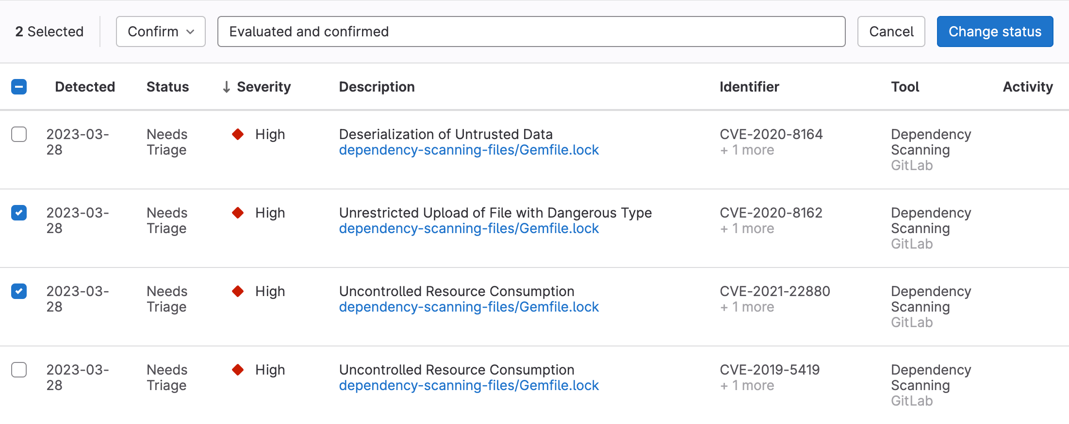

To change the status of vulnerabilities:
- To select:
- One or more vulnerabilities, select the checkbox beside each vulnerability.
- All vulnerabilities on the page, select the checkbox in the table header.
- In the Set status dropdown list, select the desired status.
- If the Dismiss status is chosen, select the desired reason in the Set dismissal reason dropdown list.
- In the Add a comment input, you can provide a comment. For the Dismiss status, a comment is required.
- Select Change status.
The status of the selected vulnerabilities is updated and the content of the vulnerability report is refreshed.

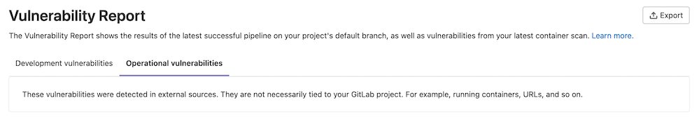

Operational vulnerabilities
The Operational vulnerabilities tab lists vulnerabilities found by Operational container scanning. This tab appears on the project, group, and Security Center vulnerability reports.
