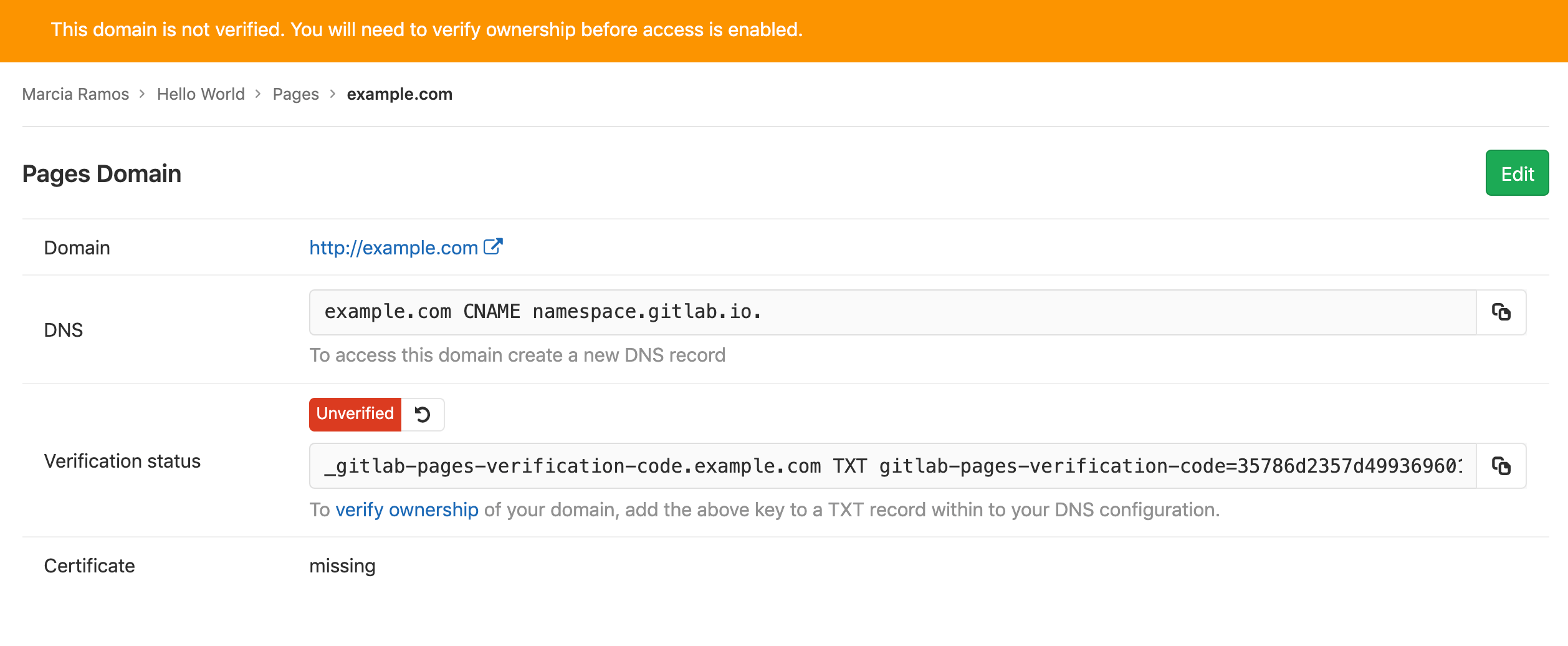

2. Get the verification code
After you add a new domain to Pages, the verification code prompts you. Copy the values from GitLab
and paste them in your domain’s control panel as a TXT
record on the next step.

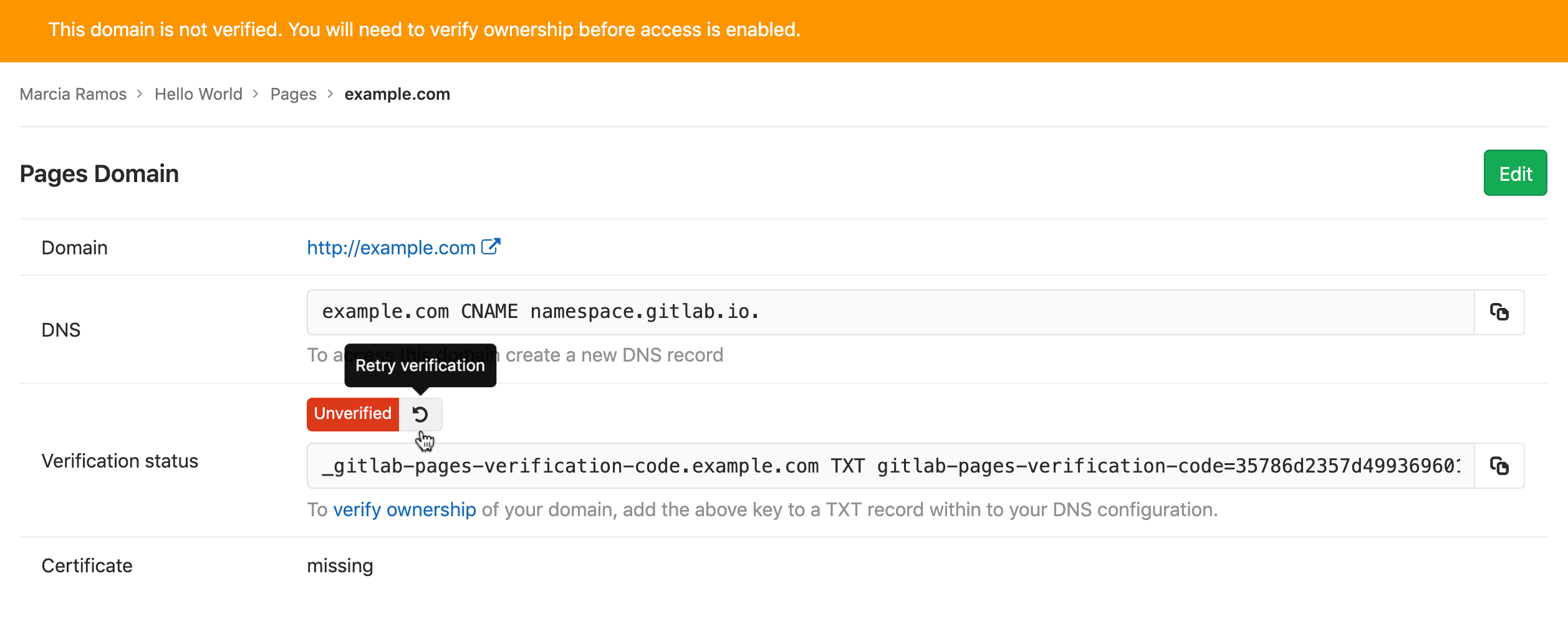

4. Verify the domain’s ownership
After you have added all the DNS records:
- Select Deploy > Pages.
- Next to the domain name, select Edit ().
- In Verification status, select Retry verification ().
As soon as your domain becomes active, your website is available through your domain name.
